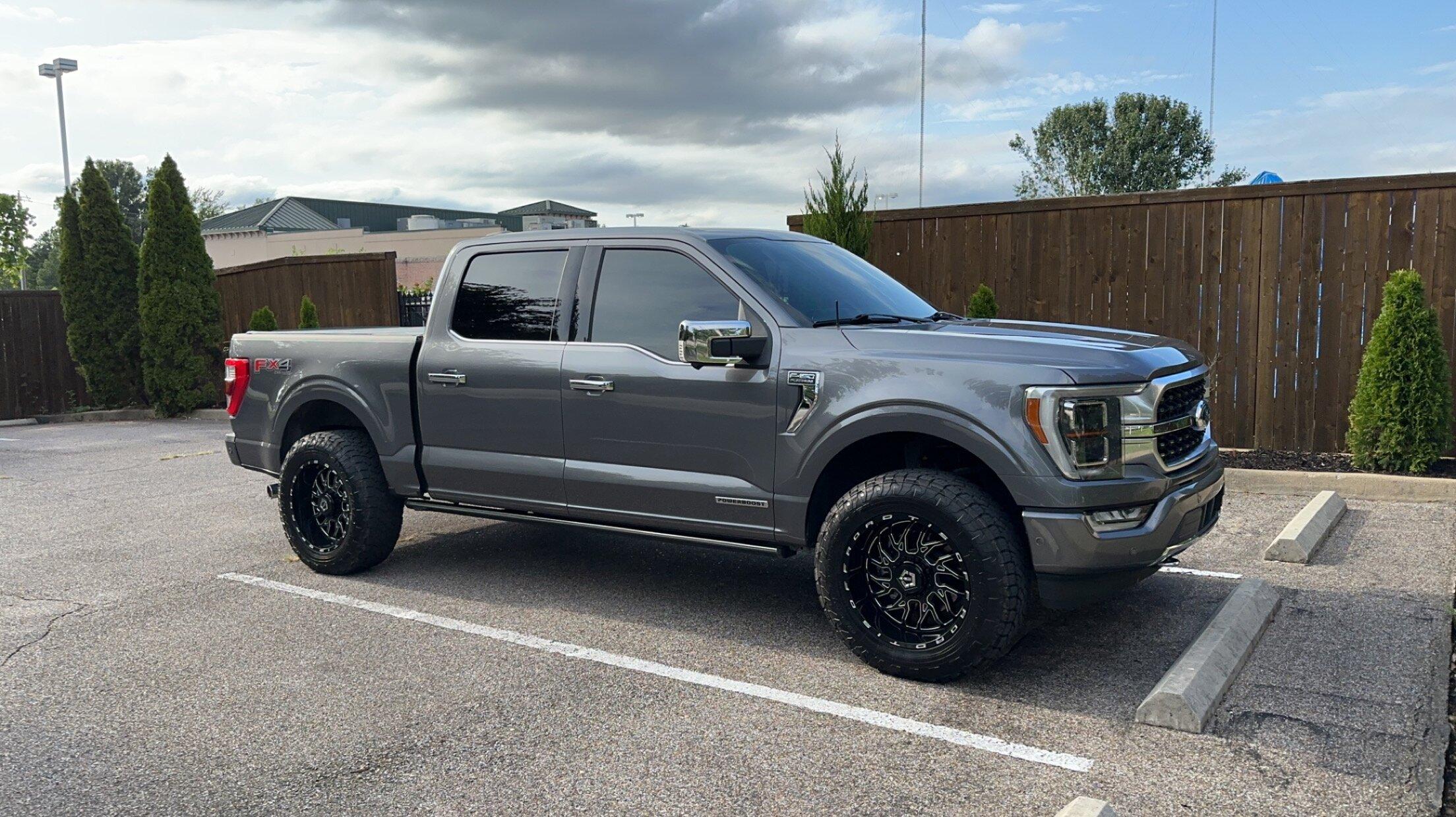

Looks great. What size tires exactly and what size and offset wheels? Did you have to do any trimming? Any rubbing while cycling through the suspension with the wheels turned either way?

That’s a beautiful truck.
Tires are a 275/65R/20. The tires are Toyo Open Country AT3s. Rims are TIS Off-road 544BM with a -18 offset. I had to trim just the curl of the from valence. It still runs just a little a full turn.

I saw the tire size and thought, "34s + level should have fit with no trimming required. Then I saw your offset was (negative) 18 and not the more common (positive) 18.

Looks great! I have a 21 Platinum I want to level. I was looking at the readylift however it states that it is not compatible with Ford BlueCruise. I use my bluecruise regularly. Did your lift compromise the function of BlueCruise on your truck? Also, does a leveling kit void the warranty plans from Ford?

Looks amazing!!

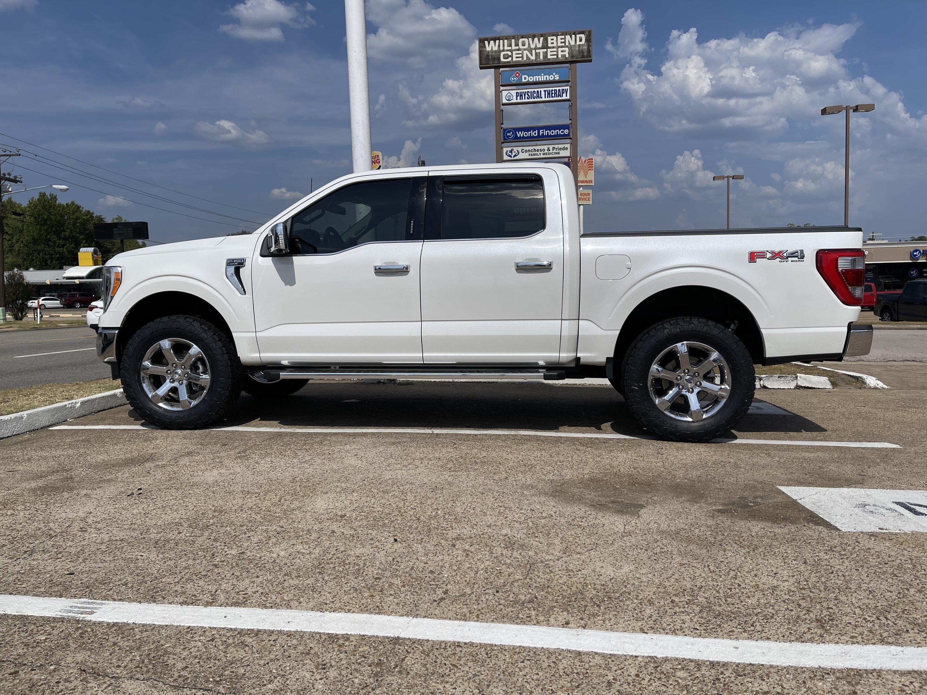

I’ve got a 2023 Lariat 5.0 SC FX4 Fox Stage1 2” leveled on Open Country3 285/65/20’s with absolutely zero rub. I also replaced the rear 1.25” blocks with 2” Zone blocks which I like the slight rake and gave me an extra .5-1 mpg. I first ran the Falcon Sport Tow 0-2.5” with the adjustable rear switch and that was a disaster as truck rode absolutely horrible like a 3/4 ton, switched to the Fox 2.0 and rides awesome especially with these larger Toyos.

fox are going to ride the best because of the type of internals they run. the only downside is you will have to rebuild them around 50k miles compared to 100k with bilstein/eibach.

I’d buy either one of those if they rode like these 2.0’s or better. As a matter of fact I’m slightly concerned of the handling capabilities of these 2.0’s while running these 34.6” Toyo AT3’s as it seems there’s over bouncing like they’re over stretching due to the actual shocks up front not slowing things down going over dips in road. Have been contemplating switching to the adjustable Fox elite series but would much rather wait till I do a 4” lift instead in a couple years.
