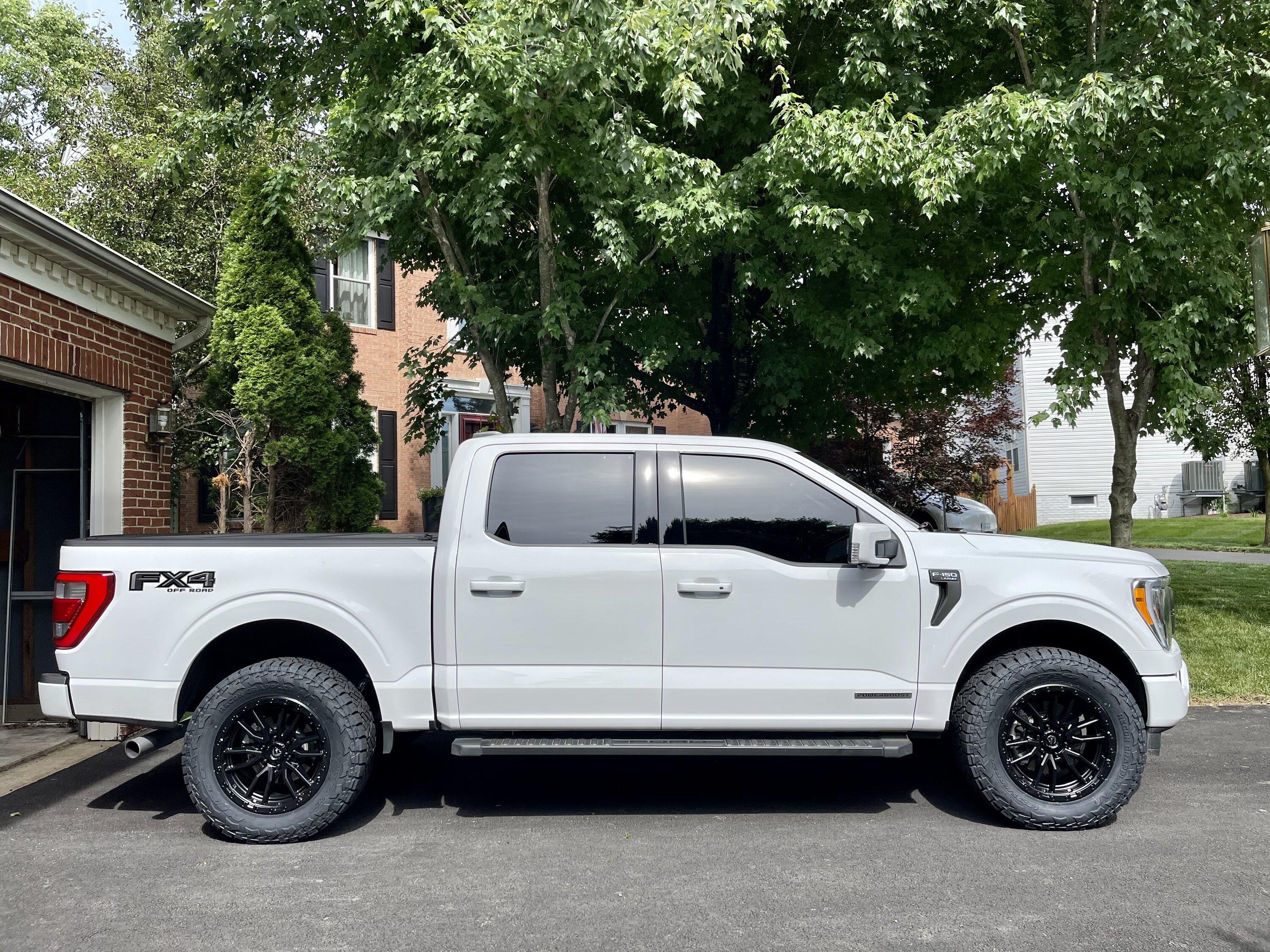

What did you end up doing? I didn’t do a before measurement unfortunately, but I ended up with still having 2 and 7/8 inch rake on mine. I don’t really feel like it lifted the front end much at all. My CV angles are pretty flat too

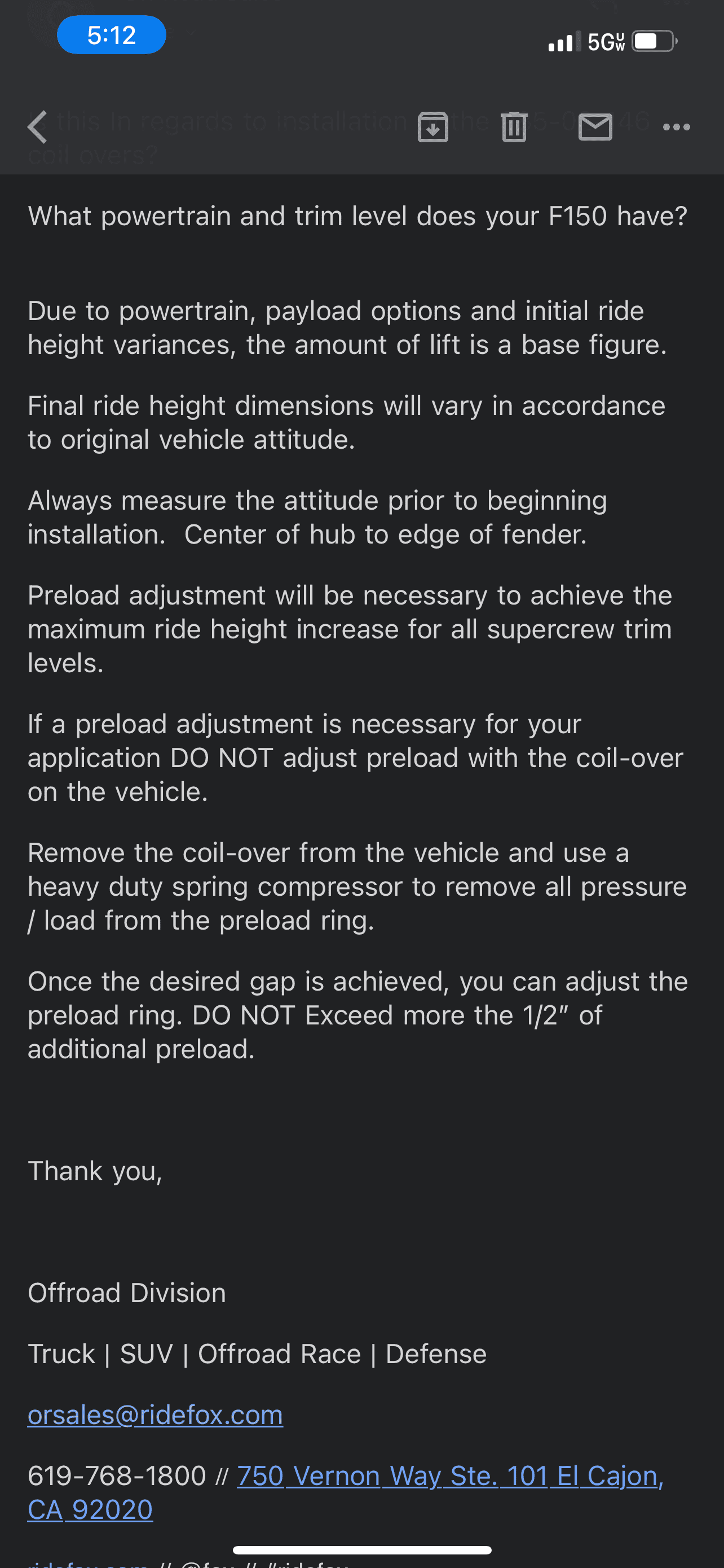

You might as well. See the photo below for Fox’s response to my email

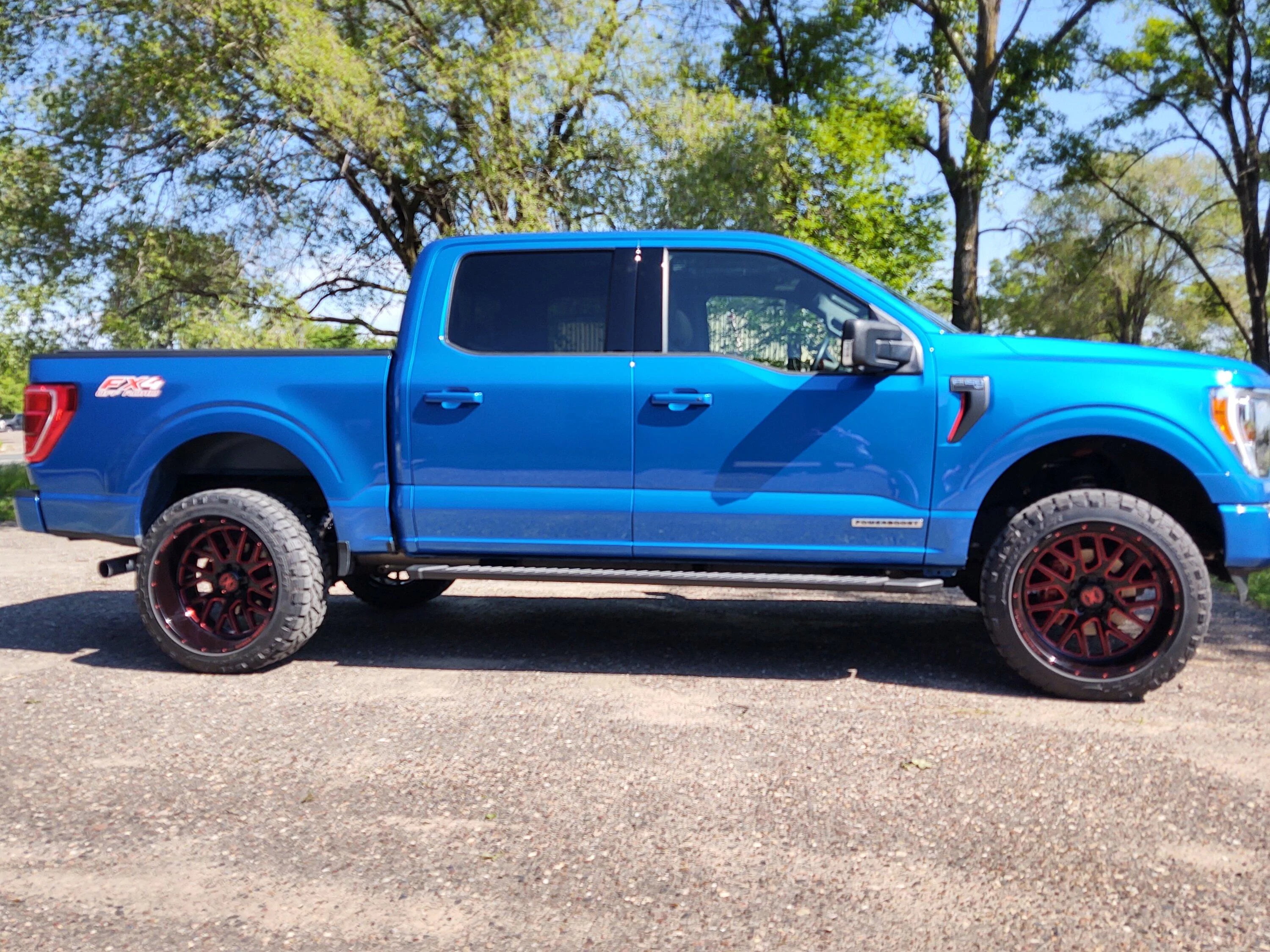

Cranked the collar another 1/2 and added another 1.5" of height to the rear.
