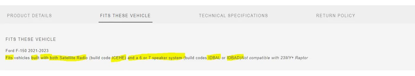

Has anyone installed the vml3z18808a ford/kicker sub kit on a 22 with the Sirius and connected NAV delete. My truck had a forced delete at build and I see a little note on the copmatability chart that it works on trucks with Sirius only.
Could the APIM be missign a plug or something? I would like to stay as factury original as possible with this truck and not go compelte aftermarket.
