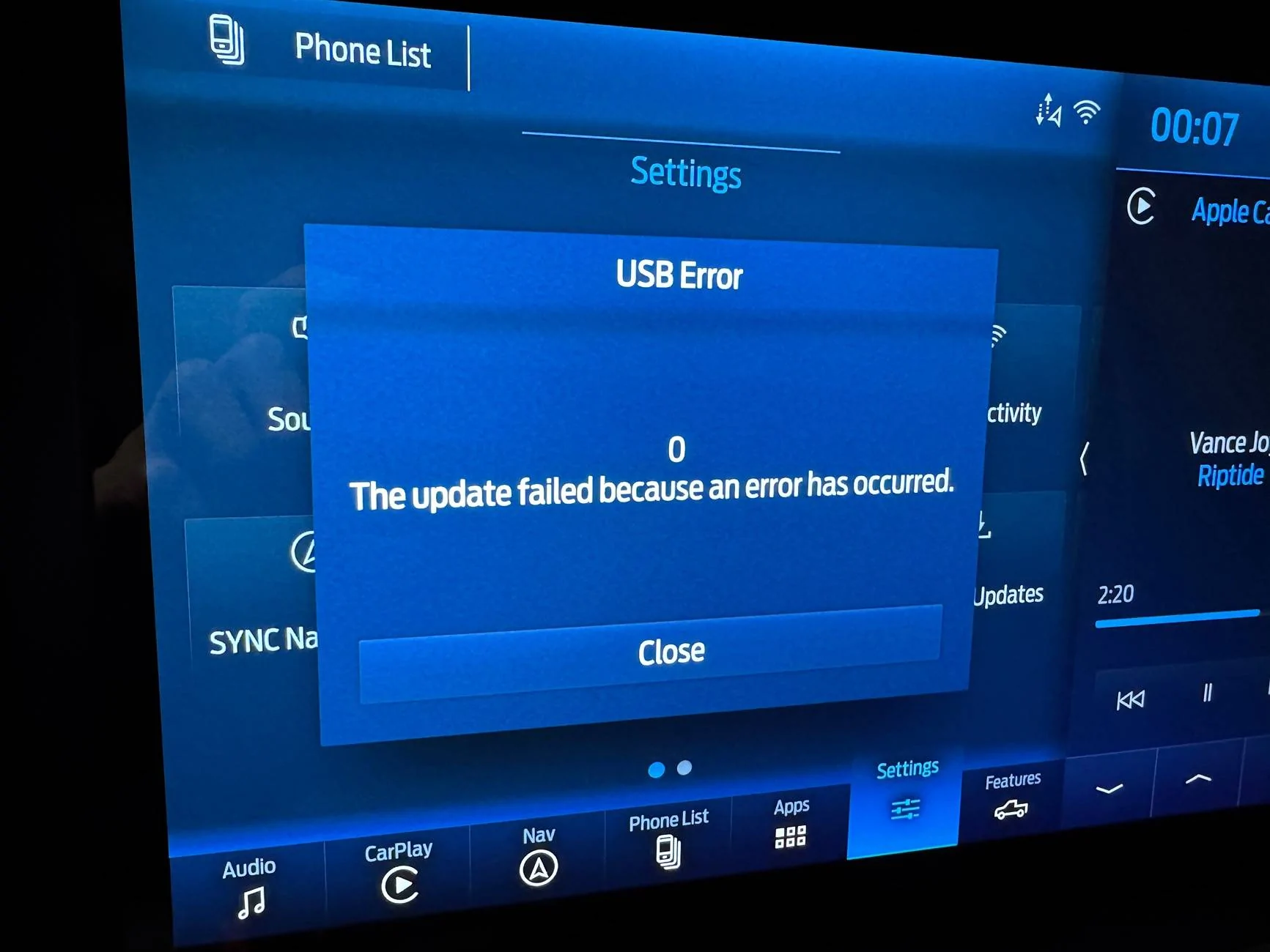

If it still is an issue after some time I would try another USB just to rule it out. Easy enough to copy the files over.

Well at least you know that it's kicking off and attempting to apply the update. Twice already.
Try a new USB stick? Or USB drive? Maybe the USB C interface this time?

Yeah that might worth a shot. I might leave this one in a little bit longer but if it does it again I’m definitely trying a different usb drive. USB C might be worth a shot
What size have you been using?
I've been using 32 GB.
