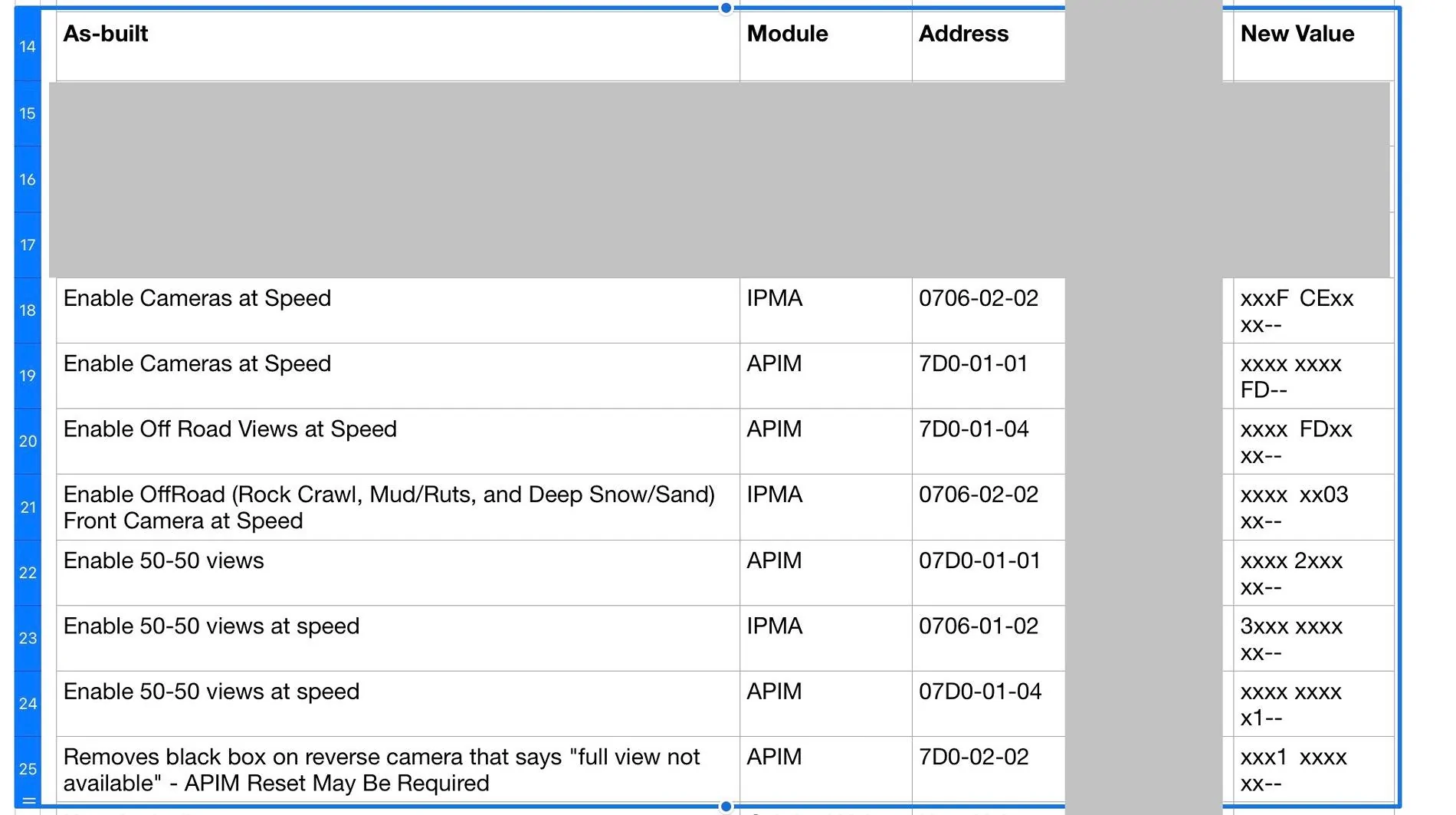

The sheet has changed some because of '24 trucks and recent features. This set of camera changes works for me:
Ford F-150 2021+ F-150 FORScan List / Database / Spreadsheet IMG_4877

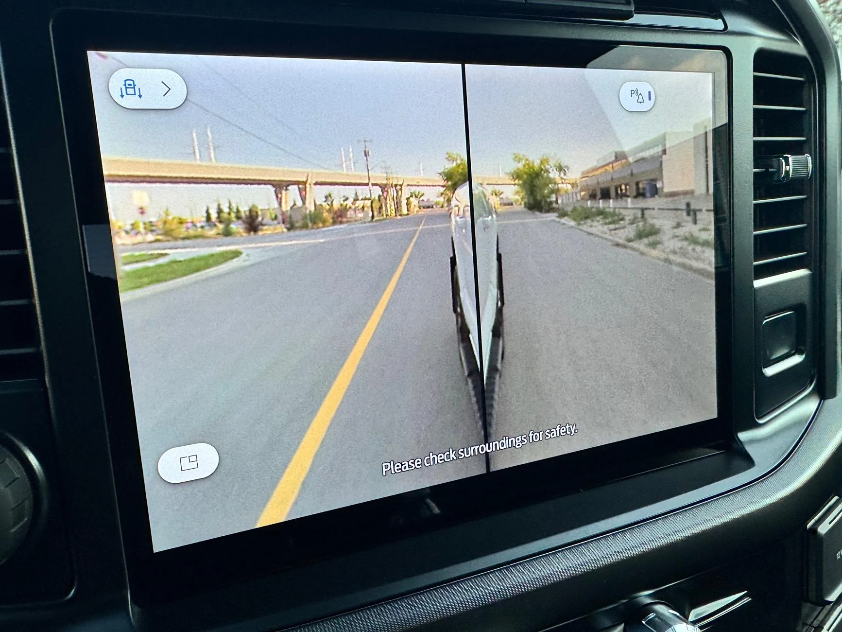

Are you talking about this? 50/50 in motion?
-this is on my 2024 F-150 Lariat BAP 502A high

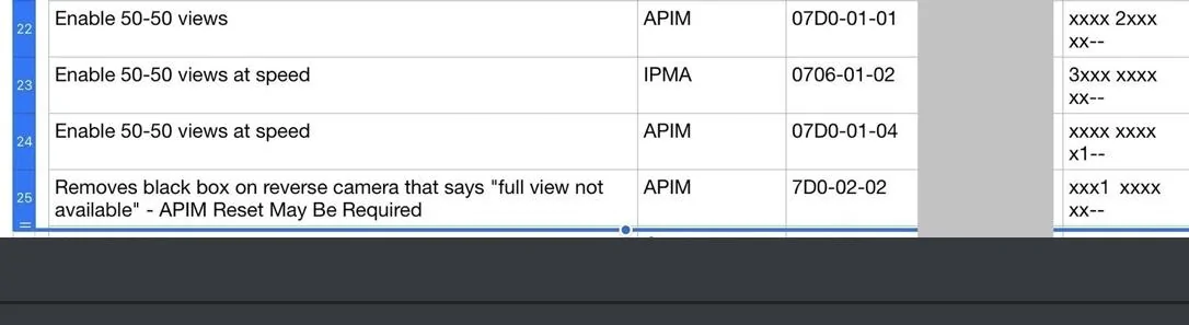

Mine came already enabled on my 24 Lariat from factory so I didn’t have to do anything, but by looking at the picture that @SilverPigeon attached above, you need to enable the first 3 on FORScan (APIM and 2 IPMA changes — ignore the last one for removing box on reverse camera).
Make sure to backup each module before making any changes in a separate folder so you can revert if it doesn’t work.

Yes, change both. You are changing the IPMA so that it gives the correct image to the APIM. You are changing the APIM so that you have the Choice for that view on the camera menu.
What you really should do is go character-by-character. For example, where I have a 2, look at the detailed tab in the spreadsheet and see what it does. For example:
2 =BF Non-Brazil or Brazil Frequency is not Supported by Radio • CTB Not Present • V Enabled • LD Disabled
V enabled is the 50-50 View. If yours was originally 4, it would mean CTB is present. Therefore to keep CTB and Views, you would make it 6. Remember, that's an example. If you had 0, you need 2 which enables Views without the other settings in that character.
spreadsheet is just one I made to document the individual changes l made to my truck. You should document any change in some way so that if needed, you can manually restore each change.
