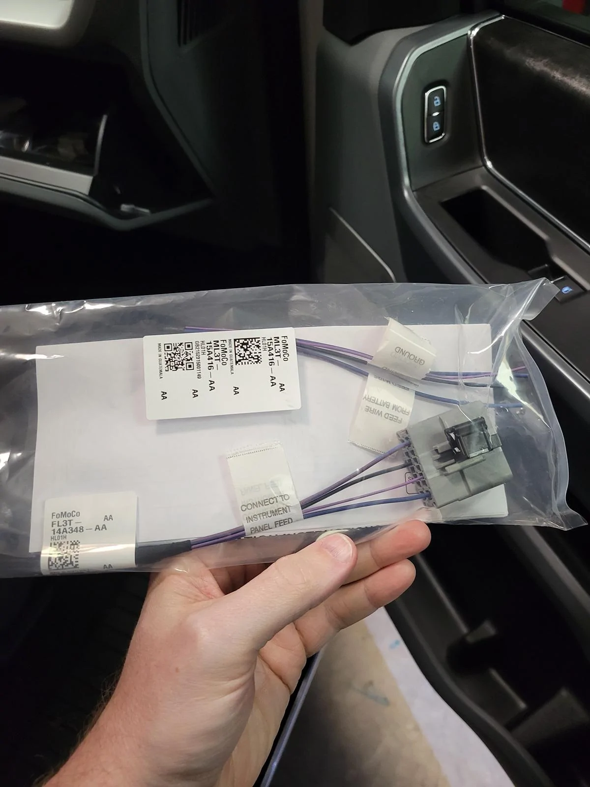

There is a pig tail you can plug into for the trailer brake that is 12 volts. It looks factory too. Just use that as a 12 Volt source. It's in the footwell in the driver's side.
Ford F-150 12V DC power source in dash 20240313_110510
Ford F-150 12V DC power source in dash 20240313_110617
